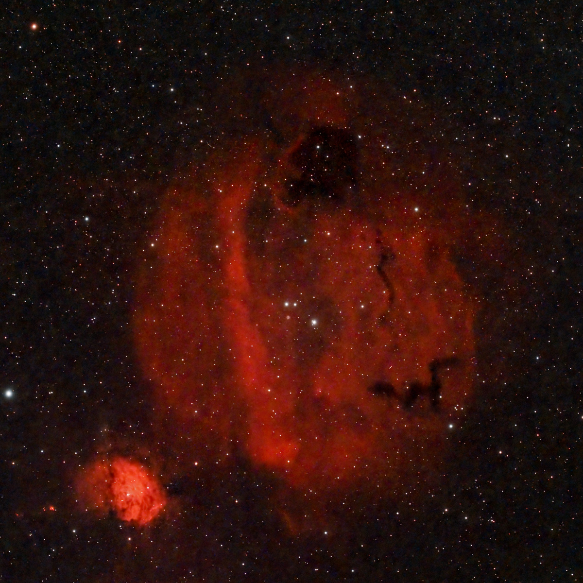

Charlie Brown would image this one for sure if he was an astrophotographer!
I have never seen this one before, I found it while poking around in the sky looking for objects to image while zoomed in on the app SkyGuide. Here in SoCal at my place here I have a very limited view of the sky, so I was doing some deep diving to find a few different objects to image and to also test my new Dual Band filter the Antlia ALP-T.
So I came across this area with some objects and when I googled the scientific name for it (SH2-232) I found it was being called The Great Pumpkin. And sure enough it really looks like a pumpkin from Halloween with a crooked mouth, eyes and some vertical stripes on it like a real pumpkin. I even see a hat on it. I am guessing that the name The Great Pumpkin might be a more recent name as most of the images I saw of this on Google had it being display with the pumpkin on it's side. It's not uncommon to rotate a Deep Space Astro object while processing. Now in my case, I didn't rotate anything, this is how it framed up.
38 - Lights at 600 secs with the Antlia ALP-T 5nm filter
30 - Flats
30 - Dark/Flats
30 - Darks
iOptron Gem28
ZWO ASI2600mc Pro
ZWO 120mm Mini - Guide Camera
Askar Fra500
Antlia Alp-T 5nm filter
Stacked in Pixinsight
BlurXterminator
NoiseXterminator
StarXterminator
Graxpert
Processed in Pixinsight and Photoshop
All comments are welcome,
#1 - Original
#2 - Edit - Reduced Saturation by 10%

This looks pretty darn good for Bortle 8/9 skies - great job! You may want to dial back the sharpening and/or star reduction, as it appears that the stars within the nebula have tiny dark halos around them giving the image a "crunchy" appearance. It's very subtle, and maybe an artifact/limitation of the web site, but worth looking at. And recognizing that this is art and beauty is in the eye of the beholder, I'd also tamp down the saturation and curves transformation just a little bit; not much, just enough to calm down the lower-left corner. It stands out quite a bit and the viewer's eye is drawn to that section rather than the main target.
I may have to consider getting one of those filters...

I really appreciate the thoughts and suggestions. I am not doing any sharpening on the stars, so it's either in the NoiseXterminator or I do run a star reduction routine sometimes. I know the star reduction can do just what you described. I will have to look at that closer.
It's funny, I liked how cool this looked after I got done processing it, but when I viewed it here after posting it, my first thought was man, how did it get so saturated looking? :) But I didn't change it since I posted it, I wanted to see what others thought at that point, so thanks. I will dial back the saturation.

I decreased the saturation by 10%.
