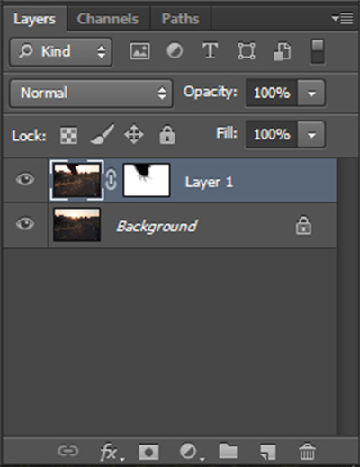

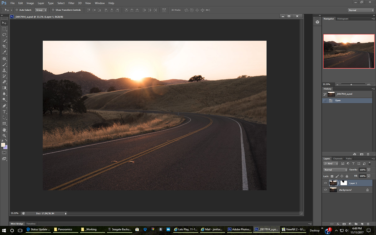

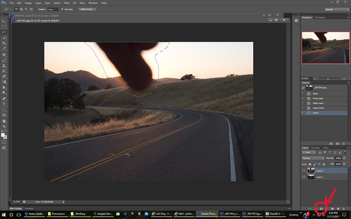

1st step is combine 2 of the photos, both then as layers, and then aligned.
2nd. Use the Selection tool to draw around the area, and then the Feather it with Select ->Refine Edge -> Feather. (Note the CC version I think renames some of the menu items)
3rd. Make sure the Top Layer is selected
-Then Press the ALT Key and Click on the Create Layer Mask Icon, its circled in Red
- This makes a Layer Mask for you from the selection. (I rarely paint, 90% of my Layer Masks are done with just selecting, feathering and creating the layer mask.
Step 3 from above will give you this:
A close up of the Layer Mask:
These are the same exact steps you will take when wanting to get rid of the smaller lens flares.
With the Smaller Lens Flares you will now just Flatten the above.
Then you Duplicate the Layer.
Then you go back and do JUST Steps 2 and 3.
After you do that, simply click on the Background (Bottom Layer) and adjust it. Whatever you do there, will show through. This is called "Non-Destructive" editing. When you are using Cutting, it is called Destructive editing because other then using Undo, you can't get back what you did. This way it's Non-Destructive.
Let me know how that gets you.
Oh, and with the sky, don't worry about it. With an example like this, after I cleared up all of the Lens Flares, remember the Darkest of the 3 photos to be used? I simply used a layer mask to replace this sky, with the darker version. So the main focus at first is getting the lens flares gone from the ground, the sky will be an easy fix.

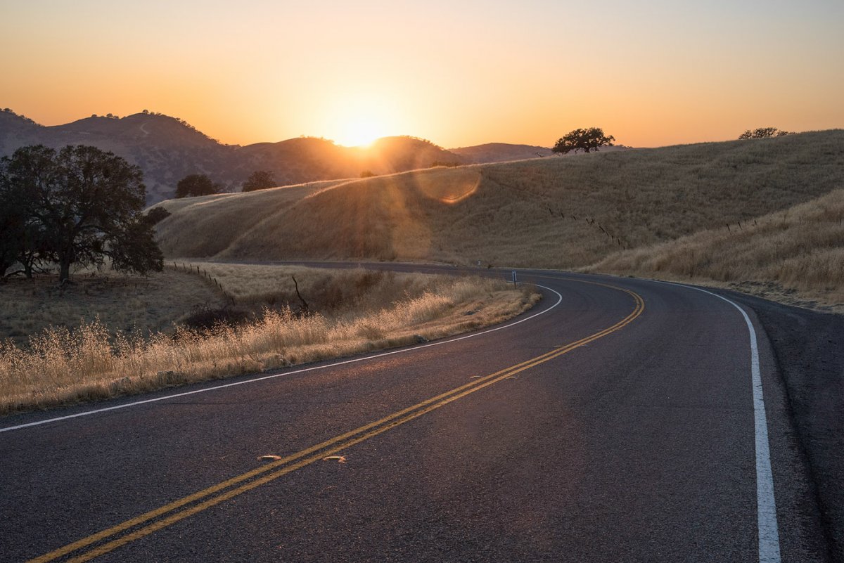

Here's my cut. I'd have liked the finger picture to have the same exposure as the brighter one, so the first thing I did is adjust them until they pretty much matched. Then I blended the three exposures, adjusted the WB a little, and added some mid-tone contrast and a little dodging.

Hey Kyle,
That's a really nice one! I shoot aperture priority, so usually when covering the sun with the finger the exposure will change, so that was part of the task here, to adjust the exposure. You did really good, I am glad you jumped in here.

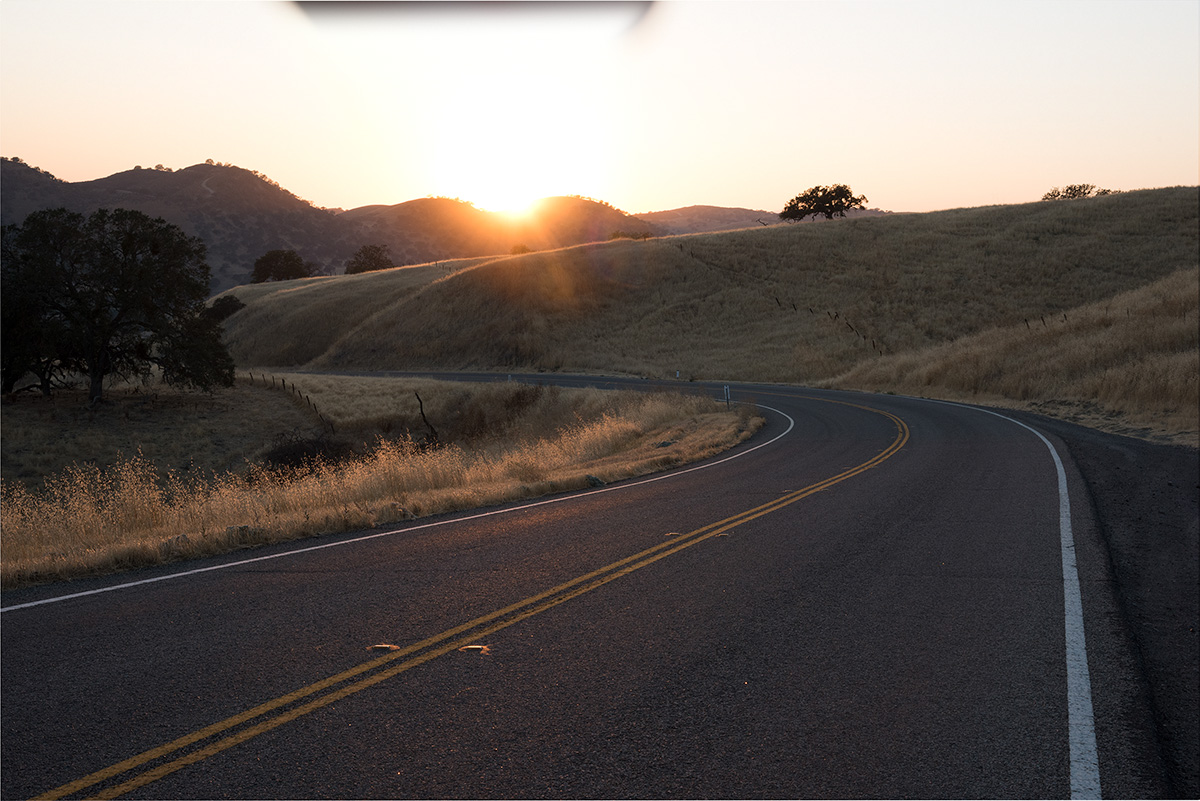

Hi Jim, I was with you up to step 3, only your mask method was different. Your result looks pretty much the same as mine, the mask area is darker than the sky, but as we both concluded, adding the sky later is easy.
Ok, Tomorrow I am going to take another crack at it with your masking method.
Kyle also put his finger on another part of my issue. I was expecting your method to perfectly eliminate the finger, but because of the mismatch in exposure, it left a witness. His idea to fix exposure first was a good one.
Yep, in my steps above I mentioned initially to adjust the exposure to match. Either before you do the mask (like Kyle did) or after, it doesn't matter. Since the Layer Mask is non destructive until you Flatten the Layer it doesn't matter when you do it. I personally like to do it after the Layer Mask is on so you can watch the difference disappear as you adjust it, but there are other times when I do this I make sure the exposure matches in all of the layers I am going to use.
Also, I didn't change it on mine going in, because I knew I was going to use the sky from the darker exposure. Essentially though that wasn't need as you can simply darken the existing sky. Either way the sky was too bright in 2 of the exposures used here.

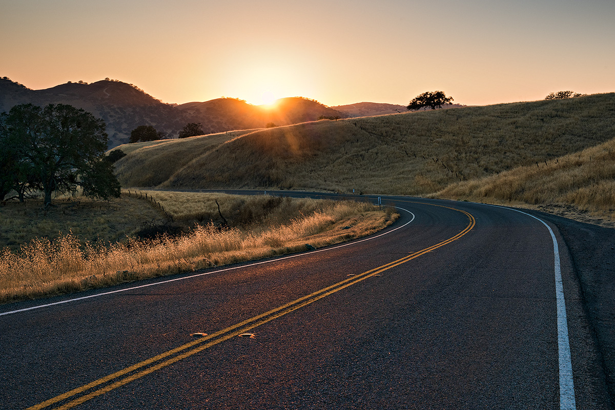

Ok, I think I have it. The big breakthrough for me was (alt mask) and the work on the background layer. All these years I have avoided doing any editing directly on that layer. The next thing was with the flare, I had to do it in two steps, because the first one was large enough to have a pretty large gradient. So I corrected it for the lighter region, then started over with what was left of the brighter region.
Here is what it looks like at this stage. I have not worked the sky yet, and I need to do some touch up on the flare. It's important to read your steps and not miss one.

That is looking really good so far! I am glad the steps I laid out here are helpful. Once you get to used to making and using layer masks like this, it will open up a new world of adjustments and testing ideas because you can do it non destructively.
Your finished one is looking really nice, it's great to see the layer masking working out!
If I am being picky I see 2 spots I would suggest working on a little more. Let me download this last one of yours so I can mark up those spots for you.
Hey Ben,
The 2 last things I would suggest for yours.
In the white half circle flare, just layer mask with drawing close to it, and a small feather of about 5, probably like you did with that larger one.
In the Red one there is still a few artifacts left from that large lens flare circle. You eliminated the flare really well, so good job on your doing that. But at this point (I had to do the same thing on mine) select that area in Red, then you can use Content Aware Fill to help spread the orange/yellow sun glow evenly in that area to match the left side. I also then used the patch tool, and then used as the source from the left side. The goal there is an even flaring of orange around the sun.
