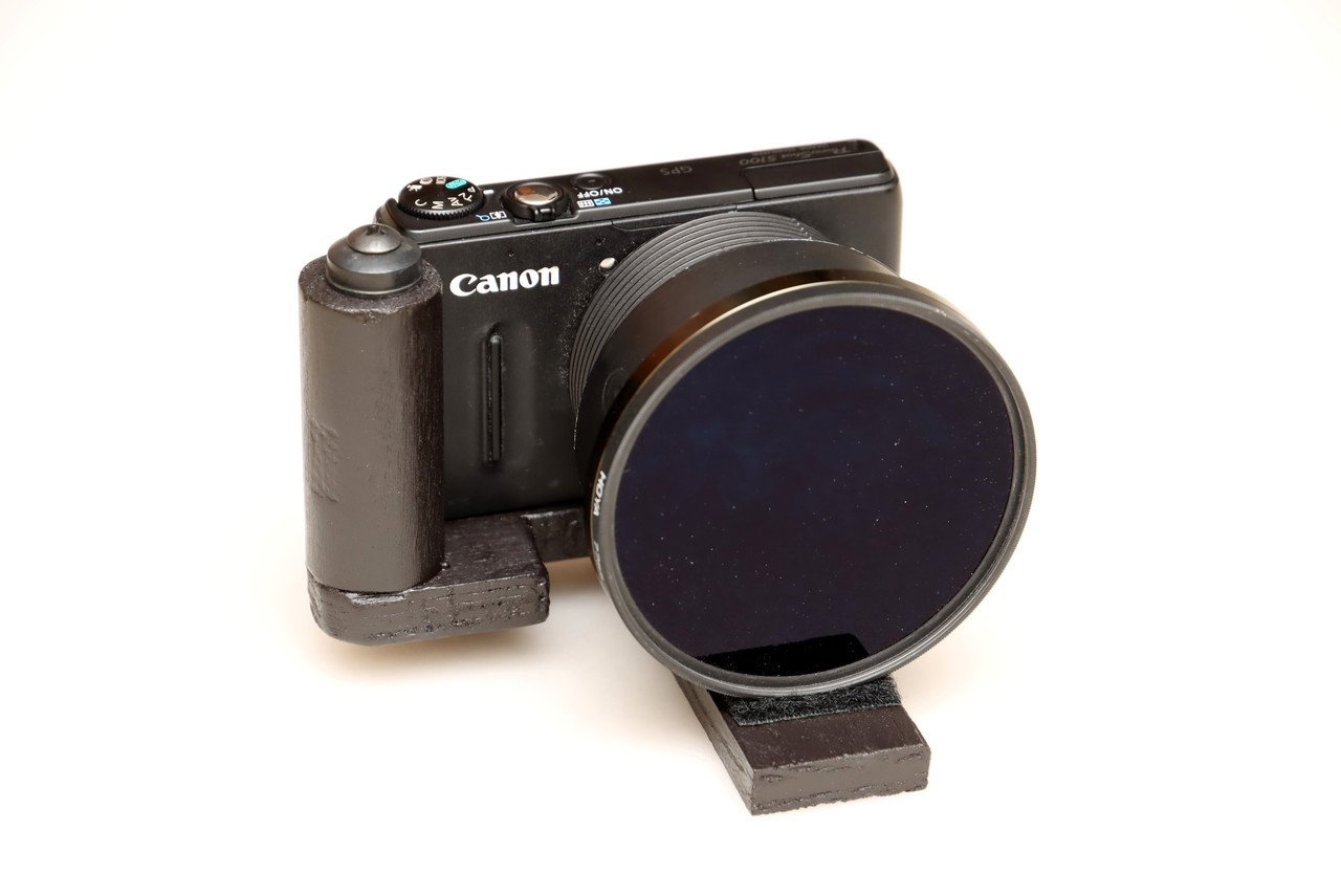

And you converted the camera yourself? That's pretty cool, I had mine sent out and got it converted to 590nm, but I think 720 is better for Black and White.
Yeah, I like tearing objects apart and seeing if I can rebuild them!
Actually though, it's not terribly difficult taking a camera apart for IR conversion. The issue I was running into was the hot filter. Once it is removed many camera will not focus properly without it. My little Canon focuses fine; go figure. I used a piece of PVC pipe and a step up filter adapter for my Hoya R72 filter. It's an ugly looking camera but it works. Though lately I've been getting the Canon "lens error"; which is common in this unit. But if I smack the body hard a couple times it fire right up. Though I do believe this camera is a ticking time bomb waiting to go off!
Oh man. I have to say its perhaps so ugly, you have to just love it? :)
