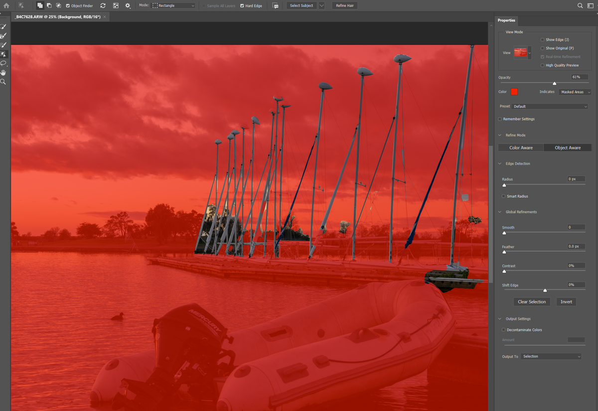

Photography is the art of painting with light. In the modern age, it expands into the realm of digital post-processing. With a plethora of tools in photo software, I try to learn something new every month, sometimes a suite of new programs, sometimes just a new feature.
This week I have been using the "select and mask" tool in Adobe Photoshop, with each new iteration, this tool is getting better at detecting objects in complex scenes, I could fine-tune the mask to make the selection very precise.

Ken, thanks for sharing your work process, many of the steps you described are just what I do, especially when it comes to ultra wide angle shots and complex scenes.
The “Select & Mask" object tool selection is working much better than a few versions before, it works best when there is a slight contrast, by
Pressing ALT or Shift with left mouse click button, I can modify complex masks easily, the software must have gone through an algorithm change.
