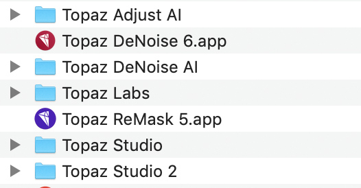

All of my Topaz plugins are located in separate folders within the Applications folder (MacOS). Your reference for the location looks like the Windows file system. I have had to restart Photoshop after each Topaz update (there have been a lot this summer).
