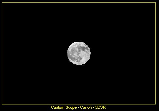

2) Untracked fixed tripod images of Solar System Objects. These objects are very bright (as anyone who has placed the moon in a dusk or nighttime composition and expected to get good foreground AND moon detail knows) and therefor can easily be imaged without any tracking ability. In fact, state of the art Solar System imaging is typically done by shooting video, and then post processing the video to extract only the frames that are least affected by atmospheric turbulence (called seeing), and then aligning and stacking those to get a final result. Generally speaking, much better results can be achieved this way than by shooting a single still frame, unless you are located somewhere with exceptional seeing. The trick for this type of imaging is focal length, as even a 600mm optic produces a relatively small moon image on a full frame sensor, and of course all the other objects (besides the Sun) are much smaller than the moon.
Apparent Size of Moon, 600mm FL, FF DSLR:

· Want to figure out how big that object will be in your camera and lens or telescope combo? Go to https://astronomy.tools/calculators/field_of_view/ and fill in the fields (lenses are considered a custom scope) and you can get instant feedback on how something will be framed. The moon at 600mm in a full frame DSLR image shown above came from this site.
