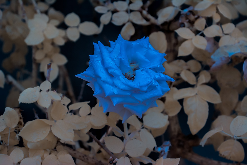

#1 - All 3 steps

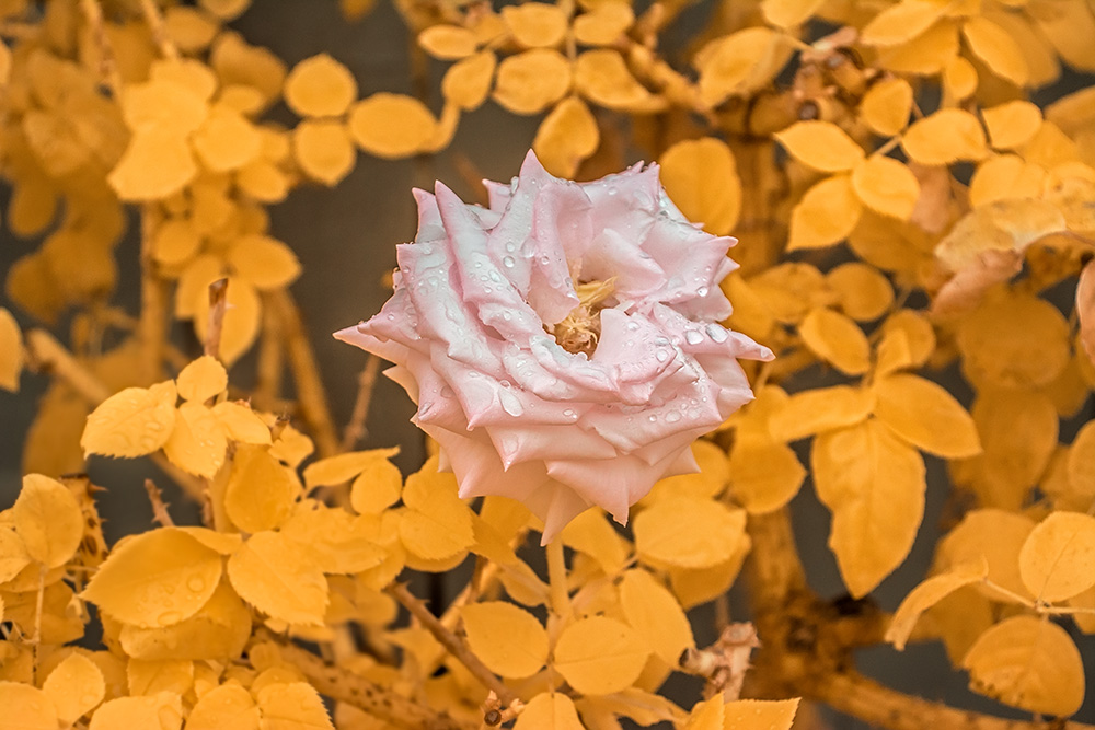

#2 - All steps but no Channel Swap

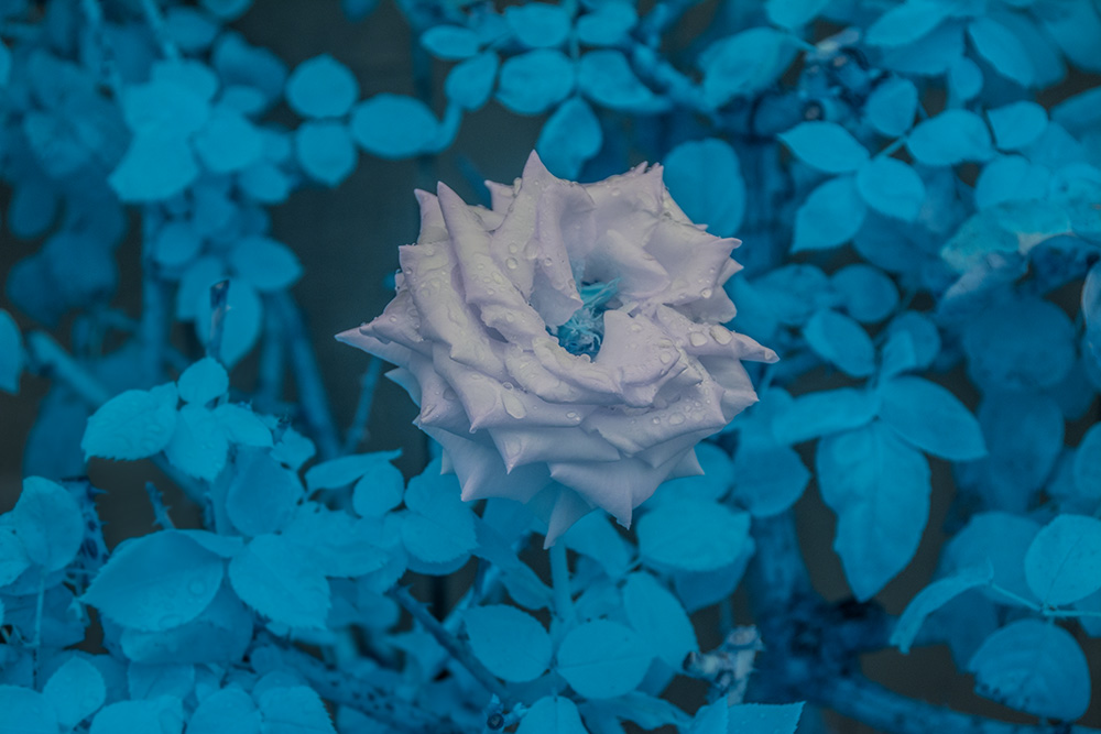

#3 - All 3 steps but a different custom WB by picking at a different place on the image
#4 - This one doesn't have the Custom WB but did have the Channel Swap

very interesting Jim. I like your first image best with the second the only real other option to my eyes. Maybe that's because as an old rose grower, I know there are no blue roses.
Amy Nelson
It's good to see you having fun with it. I would have to go with # 1 and # 2. I would like to see a little more definition in # 2.
Thanks Ben!
Remember this is IR, so there will be no normal colors. So in the IR world, there actually are Blue Roses. :)
Thanks to all of your help Amy! You have helped make this transition so easy for me.
It's funny, every time I scroll through the list I come up with different favorites. But I would be lying if I didn't say that I really liked Ben's blue roses the best... :)
