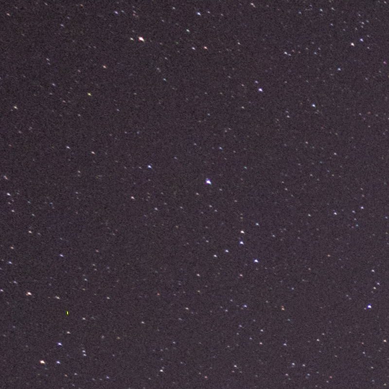

2) This is a 100% crop of the top left corner. You can see some coma in the brighter stars, but I can completely work with this.

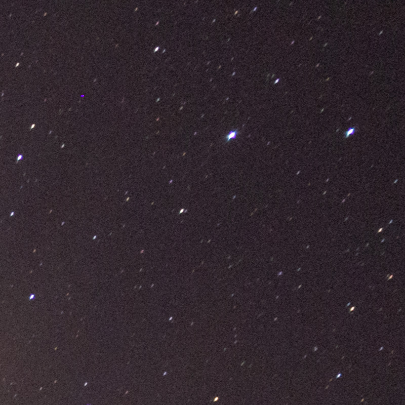

3) 100% crop of the top right corner. There were some brighter stars here and the coma is a little more pronounced. But at f/1.4 I still think this is a keeper.

I would declare this a winner. At f1.4 to have the corners not only sharp but almost no star distortions. There is the very slightest hint of an X in a couple of the brightest stars, but it's so minimal. It's better then the 14mm f1.8 Sigma which we call the gold standard for Astro lenses.
I have a couple of Milky Way lenses that aren't this good in the corners, so I would hands down declare this a winner.

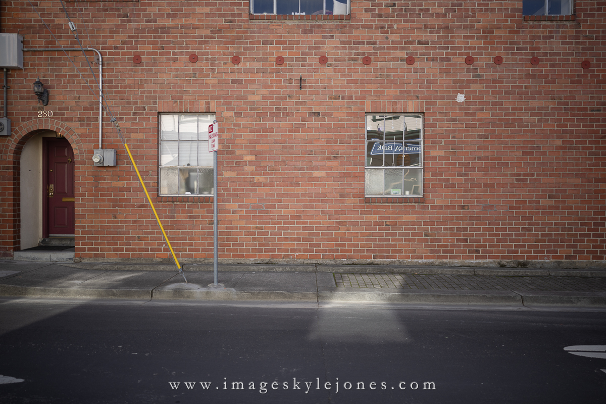

I have more comparisons on my site, but here is the scene that I used for comparison. This was taken wide open with the RF 24mm f/1.4 VCM with distortion corrections applied but no corrections for vignetting, sharpening, or noise.

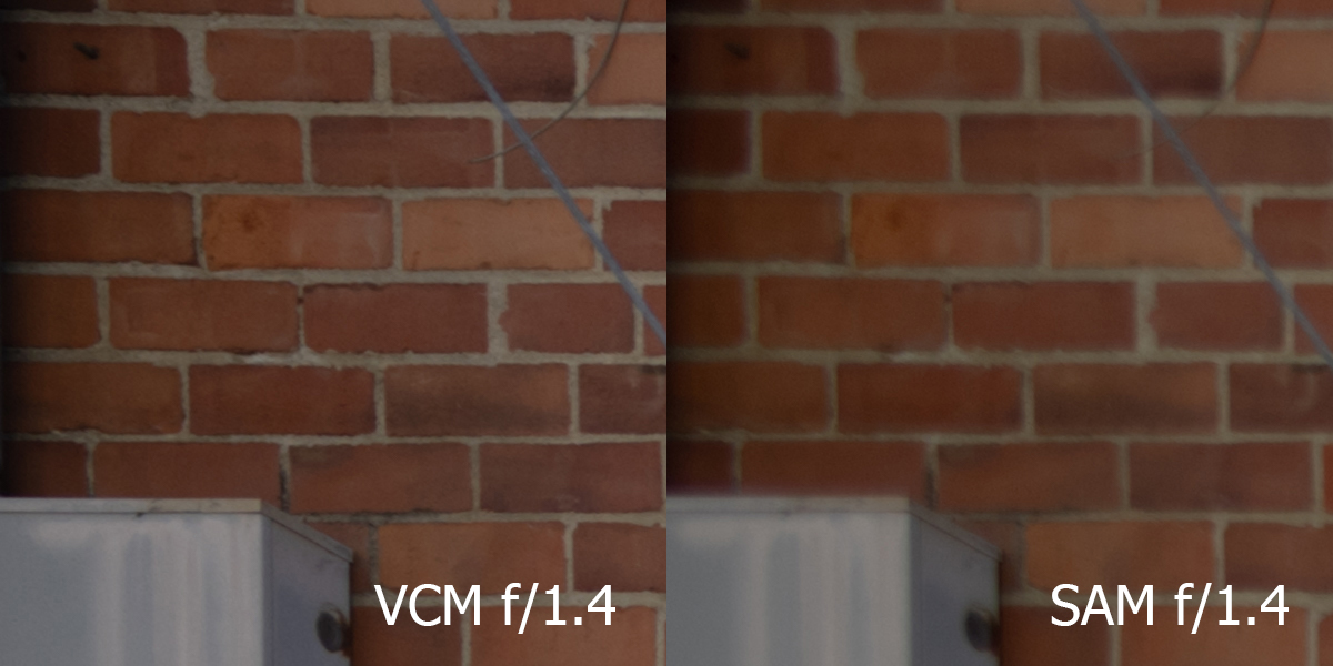

Here is the 100% corner crop comparison wide open against the Samyang. This is why I have always stopped down the Sammy and why I wanted a better, faster lens at 24mm.

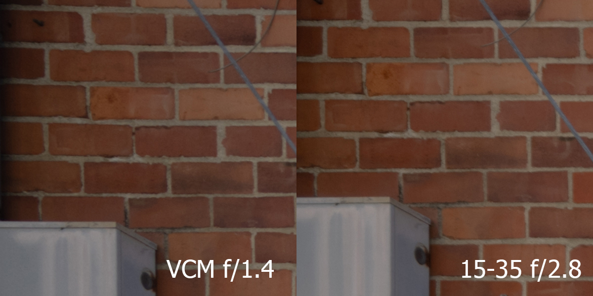

And here is the comparison of the 24mm lens at f/1.4 against the 15-35 zoom at f/2.8
