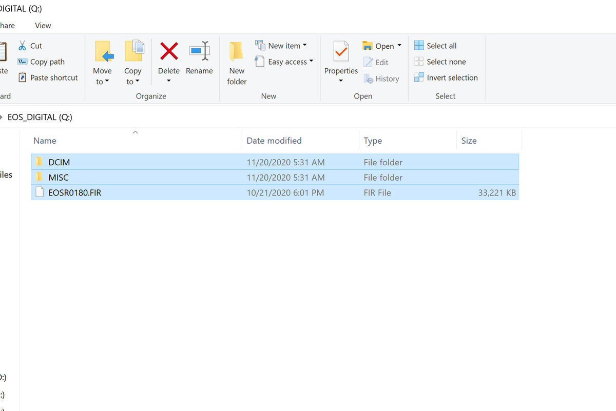

That is not the right file Ben. The file name should be EOSR5120.FIR. That appears to be the firmware for EOS R v 1.8.0, not R5. This is why the camera won't recognize it and load.
And the FW file for RF 24-105L is RF012706.afu.
Ok, I have both updates loaded now, thanks for your help. I also found the ibis setting with a 11-24 attached. I sat it to the other choice from always on, can't recall what it was named.
