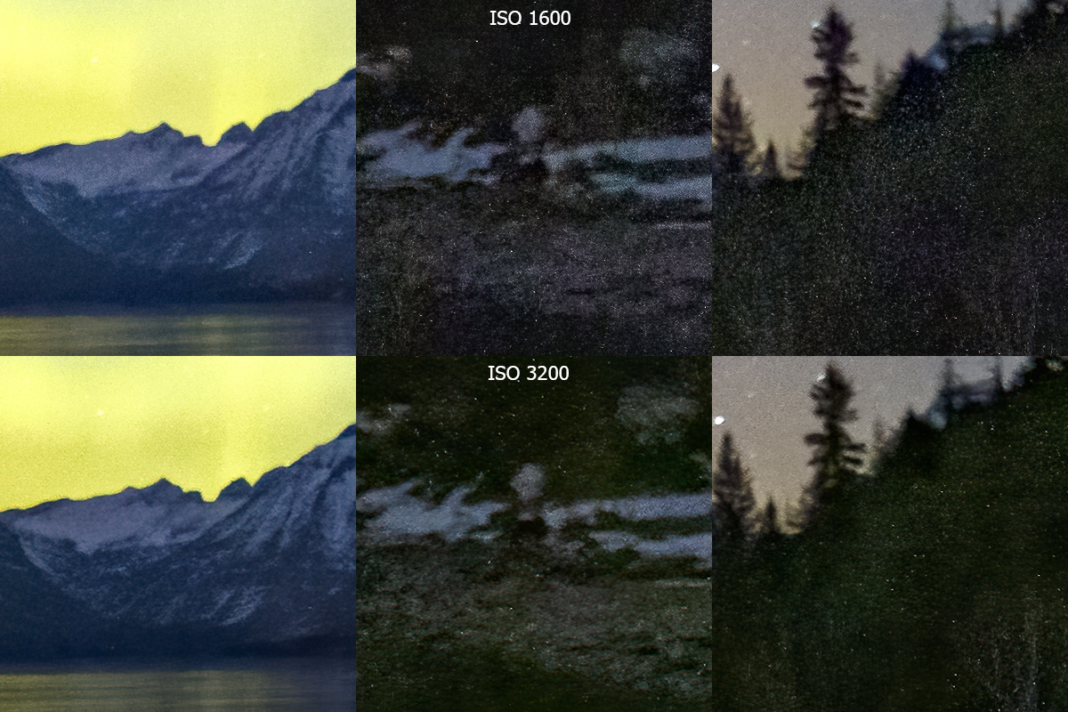

Here is a 100% crop in an area that shows relatively bright sky, darker mountains, and dark trees. The top row includes 100% crops of the above images. Just for grins I ran Topaz Denoise AI and included those versions in the bottom row.
Based on this work, I am leaning toward using ISO 1600 for my night shots with the R5. I'll probably continue taking exposures at 1600 and 3200 until I get confident with these results.

My original processing was done on the 3200 image. I just copied the settings and then adjusted the exposure of the others to match. You're eyes are correct, the differences are not large. I will say, though, that with the R5 the shadows are significantly cleaner when pushing an iso 1600 image than in an iso 3200 image with all other settings the same.

I ran auto on the iso 1600 image and it picked noise 2, sharpness 17 and recovery 10. I used those settings on the other two images.
Such a shame you had to "put up with the aurora" in your test scene. :rolleyes:
Looks like Topaz Denoise AI earns its keep with these tests results. For the record I am not that far off of these results with the 5D MkIV although I prefer to stop at 3200 if I can. I did set my auto ISO limit to 3200 so I can just set it to auto when I want and still stay within my noise limits.

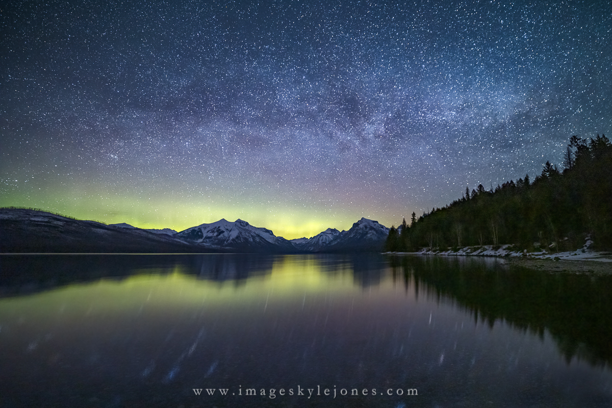

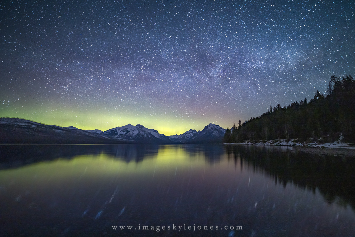

So here is my latest comparison. I ran through my full processing for both ISO 3200 and ISO 1600 images. Both of them included some Topaz Denoise. Looking at these, I think I'll stick with ISO 3200 for the R5. The shadows in the dark areas are cleaner and there is more detail in the rocks.
Full image taken at ISO 1600
Full image taken at ISO 3200
100% crops at a few locations.
I didn't take any at 4000, sorry. I'd expect it to be awfully similar to ISO 3200. My biggest conclusion at this point is that the R5 works pretty darn well at ISO 3200. I've also decided for the best image quality it remains preferable to blend. I have a long (3 minute) exposure at ISO 800 of the ground layer that I will use for the finished image - at least for the dark trees on either side. The other option would be to blend multiple images (which I didn't capture). The easiest way to do this (and it would apply to your time lapse images to create a clean still photo) would be to take something like 6 identical images, process them how you like in RAW or Lightroom, then bring them in to Photoshop as layers. Select all the layers, right click, and convert to a smart object. Then change the stack mode of the smart object to median. This should give you a really clean ground layer but with a blurry sky. Then just mask in your favorite image of the sky and you are all set. With your moving clouds I wouldn't try to stack sky images.

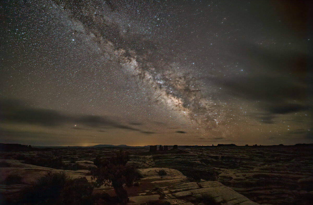

Ok, here is one using your tutorial. As it turned out the sky also blended nicely so this is 6 images using Median blend. No NR applied.
