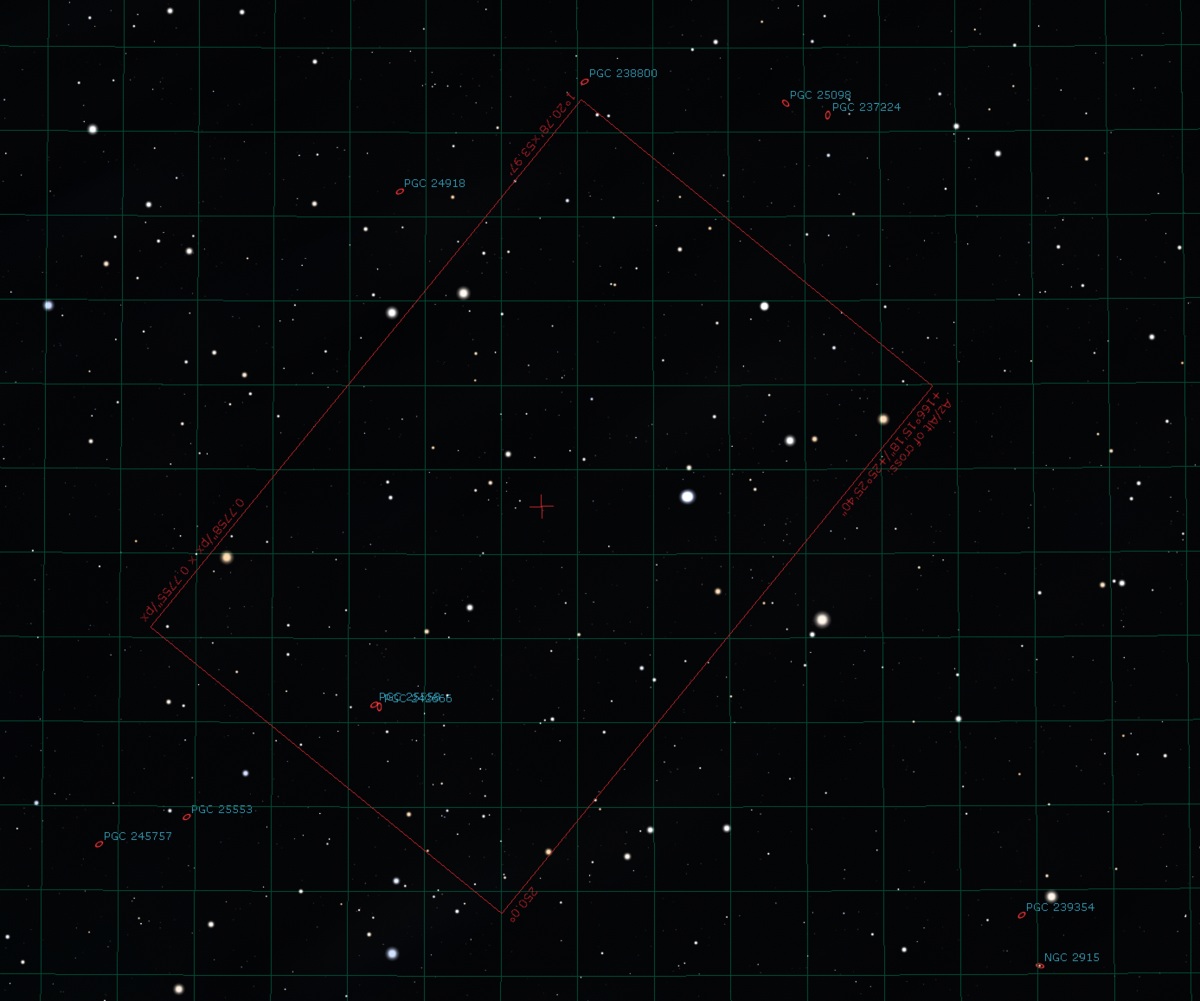

In Stellarium if you create your sensor and telescope and accurately enter the data in the Oculars area (click the spanner at top right) you should get a frame like this around your chosen target when you choose Image Sensor Frame icon, top right second from the left. Then use the arrow controls to select appropriate options
I will have to try that Carlos. I know I did in the past, and just couldn't get it to work, or it wanted me to pay something in order to work... But that looks cool.
